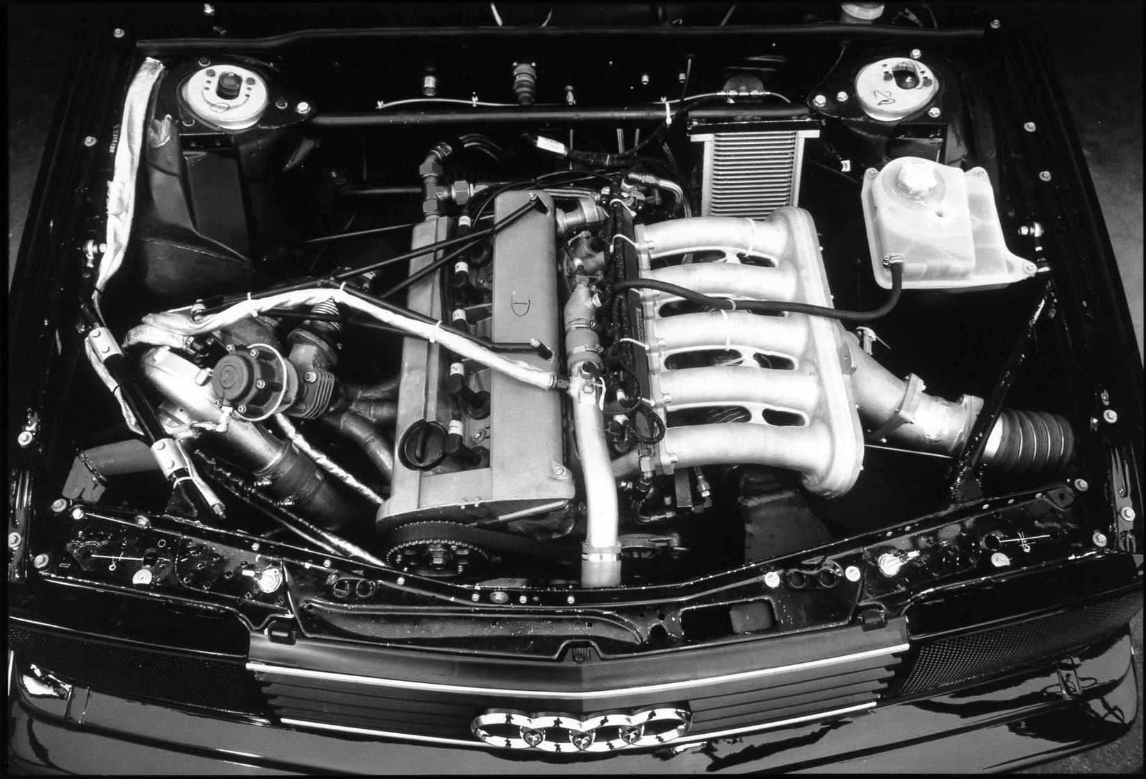

Enfin et surtout la 200, rien de moins qu'un moteur experimental, un 5 cylindres à 5 soupapes par cylindre 3 Admi et 2 échap (cela fera l'objet d'un autre post) bref le 25V le tout bien sur avec un Turbo, 650Ch au programme........

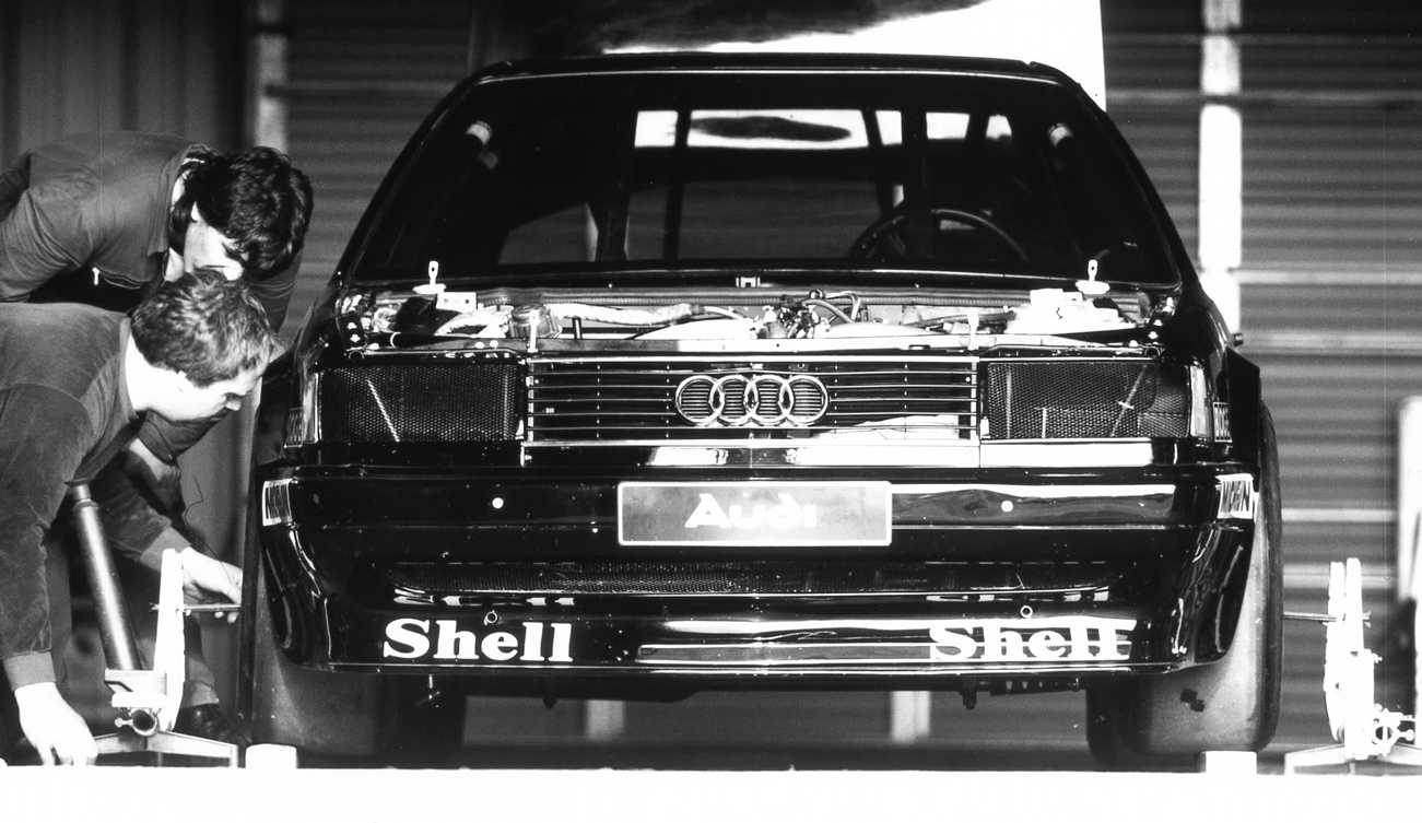

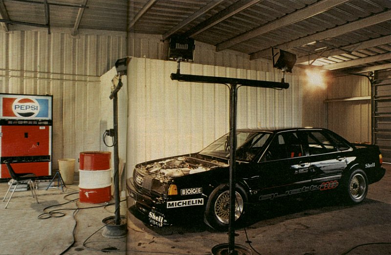

Comme le montre les autres photos l'ensemble de la voiture a été elle aussi soigneusement préparer en vue du record.

Quelques infos plus techniques:
-vilo forgé course 86.4mm
-piston forgé alesage : 82.5mm
-culasse forgé decomprimée et retravaillé avec 25v
-tx de compression 7.0 ou 8.0
-turboboost : 3.0 bar
-modele turbo inconnu mais refroidissement eau + huile
-allegement de la voiture au maximum (vitrage et carroserie notamment) pour ateindre 1072 kg
-pipe admission sur mesure et agrandit
-collecteur d'échappement inox sur mesure avec conduit plus gros

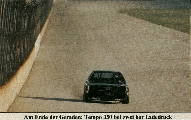

With turbocharging, all-wheel-drive and numerous hardly visible but extreme modifications (all complying with NASCAR rules!), the 200 succeeded in impressing the US. In Talladega the 200 with its 650hp reached a lap average of 332km/h (nearly 207mph). Thus it broke the big barrier of 200mph. On the straightaways it reached over 350km/h (over 219mph). In 1985 this time would have been enough for the first row in the starting line up. After this world-record for an all-wheel-drive vehicle on a circuit, the Audi team went on a promotion tour through the USA.
It is really hard to see all the changes that were made to this 200. It starts with a solid aerodynamic improvement. Drag was reduced by avoiding edges and ommiting the rearview mirrors. The body was lowered 40mm (about 1.6 inches), resulting in a smaller frontal area and a lower center of gravity. Downforce is created by the already known spoiler board up front and a small spoiler on the trunk lid. Spoilers cause downforce but they result in a higher wind resistance. Thanks to the aerodynamic changes, the cd-value of 0.33 could be kept.
The body panels were partially replaced: front and rear bumpers are made of Kevlar, doors and hoods are aluminium and the windows, apart from the windscreen, are made of plastic. The result is an impressive weight of only 1072kg.

The engine only reached 7200rpm at 350km/h, while it could have gone up to 7700 rpm. If the track had to much narrow bends or the gear box was too "long", is unknown to me. The secret of the engine lies probably in its cylinder head. Not much was told about it, except that it derived from the standard 20V. It was rumoured that it had a valve angle of 47degrees instead of the 25 of the Sportquattro.
Attention!
Till now I wondered if this might be a hemispheric cylinder head, as these use similar valve angles. But Winrich Germann sent me some pages from the "Audi Magazin", issue 2, June 1997. Besides the presenting of new engines one could read the following: "Begonnen hat alles mit ein paar schnellen Runden in Talladega, Alabama: Man schrieb das Jahr 1986, das Auto war ein Audi 200 quattro und das Triebwerk ein 2,2-Liter-Fuenfzylinder-Turbomotor mit 25 Ventilen und eindrucksvollen 487 kW (625 PS). Man fuhr dort einige Runden mir einer durchschnittlichen Reisegeschwindigkeit von 332,88 km/h, und die wichtigste Erkenntnis diese hochbeschleunigten Tests war die ueberlegene Leistungsfaehigkeit der Fuenfventil-Technologie (abgesehen davon, dass man einen Geschwindigkeits-Weltrekord aufstellte)."
Once again, this time my translation:
"It all started with a few fast laps in Talladega, Alabama: We wrote the year 1986, the car was an Audi 200 quattro and the engine a 2.2-litre-fivecylinder-turbocharged engine with 25 valves and impressing 487 kW (625 PS). Some laps with an average travelling speed of 332.88 km/h [206.84 mph] and the most important perception of these highly accelerated tests was the superior capacity of the five-valve-technology (apart from setting a speed worldrecord)."
Wow! And this is simply written in a simple paragraph! The first five-valve engine by Audi: 5x5 valves!!
If you want to see more of this engine, look at the pics I have taken!
Below this sensational head, much is stock: The block was only adapted to a dry sump (necessary due to the centrifugal forces), and the crankshaft was stock. However the piston rods were made of titanium and the pistons were specifically made with extra cooling channels. Air intake and outlet were redesigned and the "feeding" was changed quite a bit, too. 2 (two) injection nozzles per cylinder supply unleaded fuel (catalytic converter!!) according to the boost pressure. The result are solid 650PS at 2bar of boost pressure, what was not the "last word" according to some Audi people.

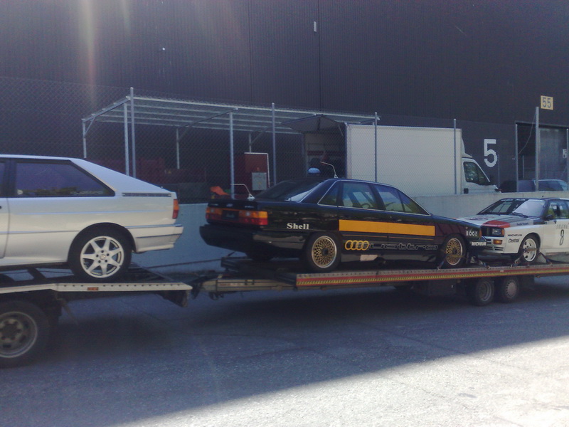

Quelques clichés provenant d'un membre d'AH :D

Alors la merci, super document, ca nous éclaire déjà sur le fait que cette voiture existe toujours, et il y a un cache culasse en plastique sur la culasse, mais je n'arrive pas a identifier le nom, cela nous donnerait un indice sur le préparateur de ce moteur.

a mon avis il y a marqué "25V TECH" .....

J'avais vu ces photos sur Audi Heritage... Mais j'ai quand même un doute sur la caisse.
Talladega avait des ailes arrière de 20v et là on a affaire à une caisse de 200 classique. Qui plus est les logotypes chromés et l'antenne sur le capot de coffre feraient plutôt penser à une "évocation" qu'à une survivante, non ?

+ 1 ;)

faites le jeu des 7 erreurs sur le moteur
Re: Audi 200 Talladega
Posté : lun. 18 oct. 2010 13:08
par Burny
Allez, je fais les faciles...
durite accordeon,
plastique cache culbu
position injecteurs,
position bocal LdR...
a vous :D
Posté : lun. 18 oct. 2010 19:52
par philweb
Le bouchon d'huile n'est pas au même endroit ! :lol: :lol:
